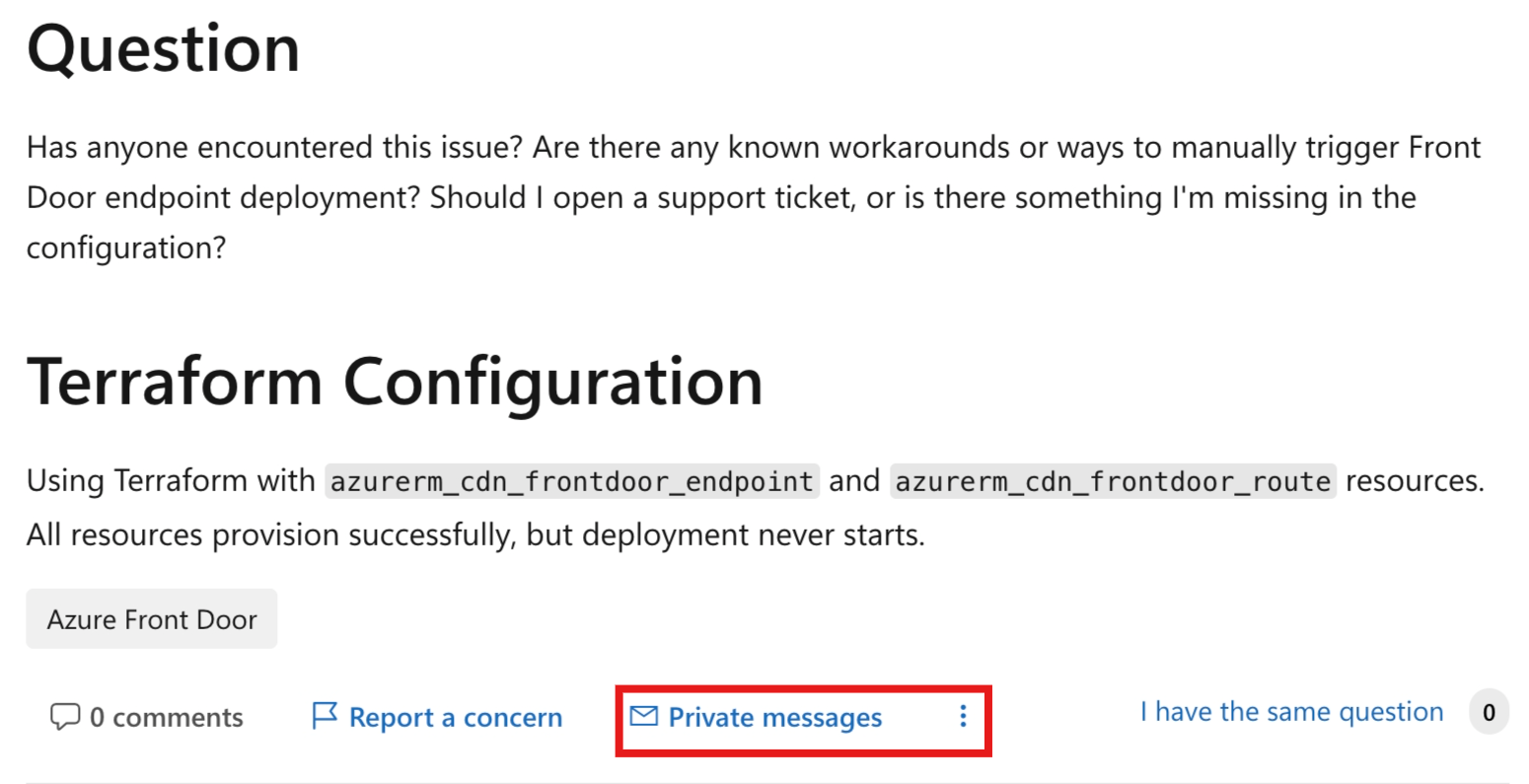

Question
Has anyone encountered this issue? Are there any known workarounds or ways to manually trigger Front Door endpoint deployment? Should I open a support ticket, or is there something I'm missing in the configuration?
Terraform Configuration
Using Terraform with azurerm_cdn_frontdoor_endpoint and azurerm_cdn_frontdoor_route resources. All resources provision successfully, but deployment never starts.

    This appears to be a cosmetic bug. As long as the provisioning state shows as "Succeeded", you can ignore the deployment status, and it will not impact the AFD in any way.
    Could you please share the details requested over "Private message".
    You can find the "Private message" option right under your question.
    Kindly let us know if the above helps or you need further assistance on this issue.
