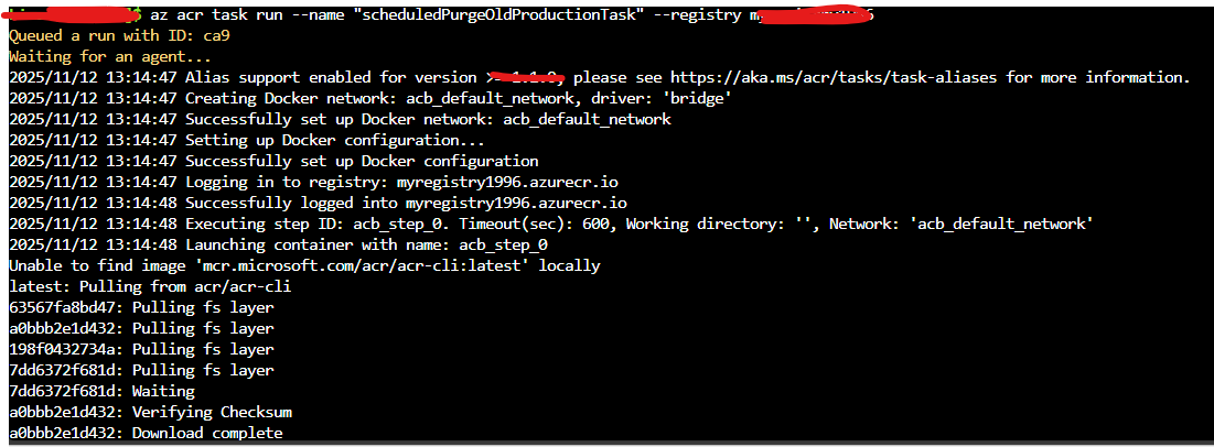

    After creating the task with the corrected syntax, test it:
    Bash
    az acr task run --name "scheduledPurgeOldProductionTask" --registry <registryname>
    for e.g tried and it works adding for ref
