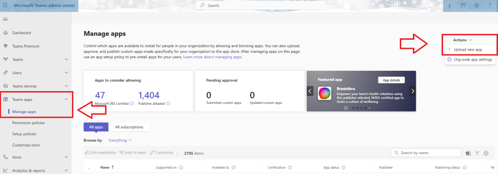

    • Go to Teams Admin Center → Teams apps → Manage apps
    • Click Upload and manually upload your .zip package
    • Approve and publish it to the organization catalog
    You can also send them the .zip file directly and request manual upload.

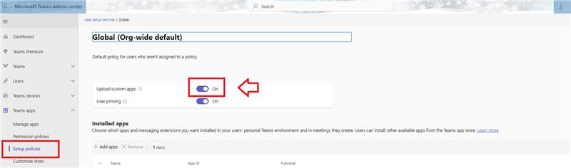

    Enable custom app upload for users: your admin must allow users to upload custom apps by configuring App Setup Policies:
    • Go to Teams Admin Center: https://admin.teams.microsoft.com
    • Navigate to Teams apps > Setup policies
    • Either: edit the Global (Org-wide default) policy, or create a new policy for specific users.
    • Enable the toggle for Upload custom apps.
    • Assign the policy to users who need to upload or test custom apps.

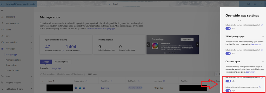

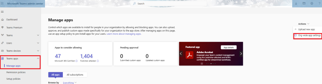

    Also, your admin can go to Teams apps > Manage apps > Org-wide app settings > turn on Custom apps toggles.
    Reference: Manage custom app policies and settings - Microsoft Teams | Microsoft Learn
    User's image User's image User's image

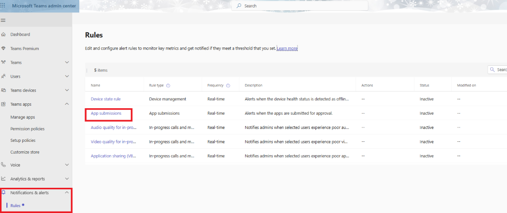

    Besides that, please check to make sure that your admin enables app submission notifications:
    • In Teams Admin Center, go to Notifications & alerts > Rules.
    • Find the rule named App submissions.
    • Set the rule status to Active.
    • Choose where to send notifications.
    This ensures admins are notified when you submit your app for approval.
