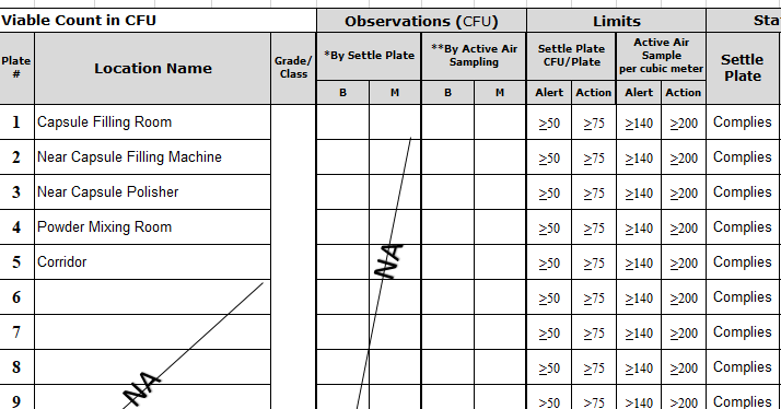

In IF formula i want to take two differen data from different cell but in response want to same response for example i sending the formula-------=IFERROR(IF(G16+H16<50,"Complies",IF(G16+H16<=75,"Alert",IF(G16+H16>75,"Action",IF(I16+J16<140,"Complies",IF(16+J16<200,"Alert",IF(16+J16>=200,"Action")))),"NA")
Here 4 type of response required (Complie,Alert,Action,NA) from 2 and 2 different cell.

  3. Anonymous
    2025-01-25T10:17:38+00:00
    Please see the screen short
  4. Rich~M 20,355 Reputation points Volunteer Moderator
    2025-01-25T22:22:00+00:00
    This is still not enough information to evaluate the formula. You did not show what columns or rows the data referred to in the formula is in. Also, the desired result and its location is unclear. Are you looking for one result that is based on two different criteria, G16+H16 and I16+J16, so that to get a "Complies" both sets of criteria must be met or are you looking for two separate results where one could be "Complies" and the other might not.
    Without knowing what columns of data your formula is actually referring to it is impossible to come up with any suggestions. Please fill in the missing information and we will be glad to assist you.
  5. Anonymous
    2025-01-27T07:43:07+00:00
    Yes sir you are saying right... I think it is impossible in a cell Two different set of data can not respond desired outputs
    it is must i choose another one cell for 2nd set of Data...
    so i did it.
    Thanks very much... Rich-M
